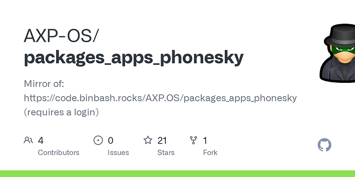

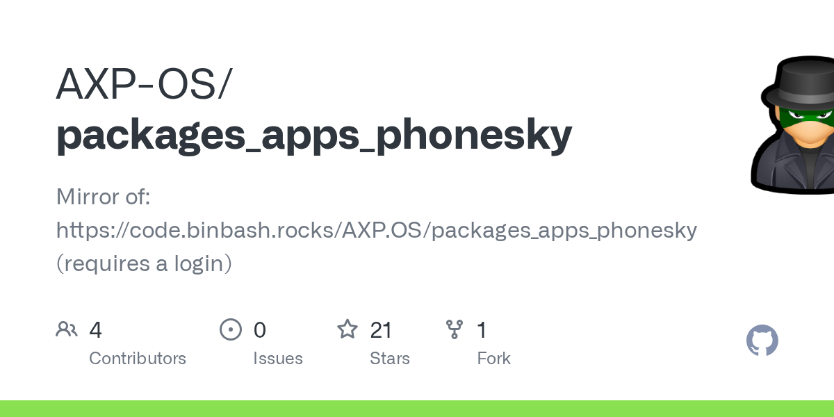

I wasn’t referring to patched Google Play Services themselves. AXP.OS used microG together with a patched native Google Play Store (Phonesky).
The relevant source is the AXP.OS packages_apps_phonesky repository, especially the patch-playstore script. As far as I understand it, it takes an official Google Play APK, decompiles it with apktool, applies the patches and rebuilds it. So yes, in that sense it is patching/decompiling the proprietary Play Store APK rather than building Google Play from source.
