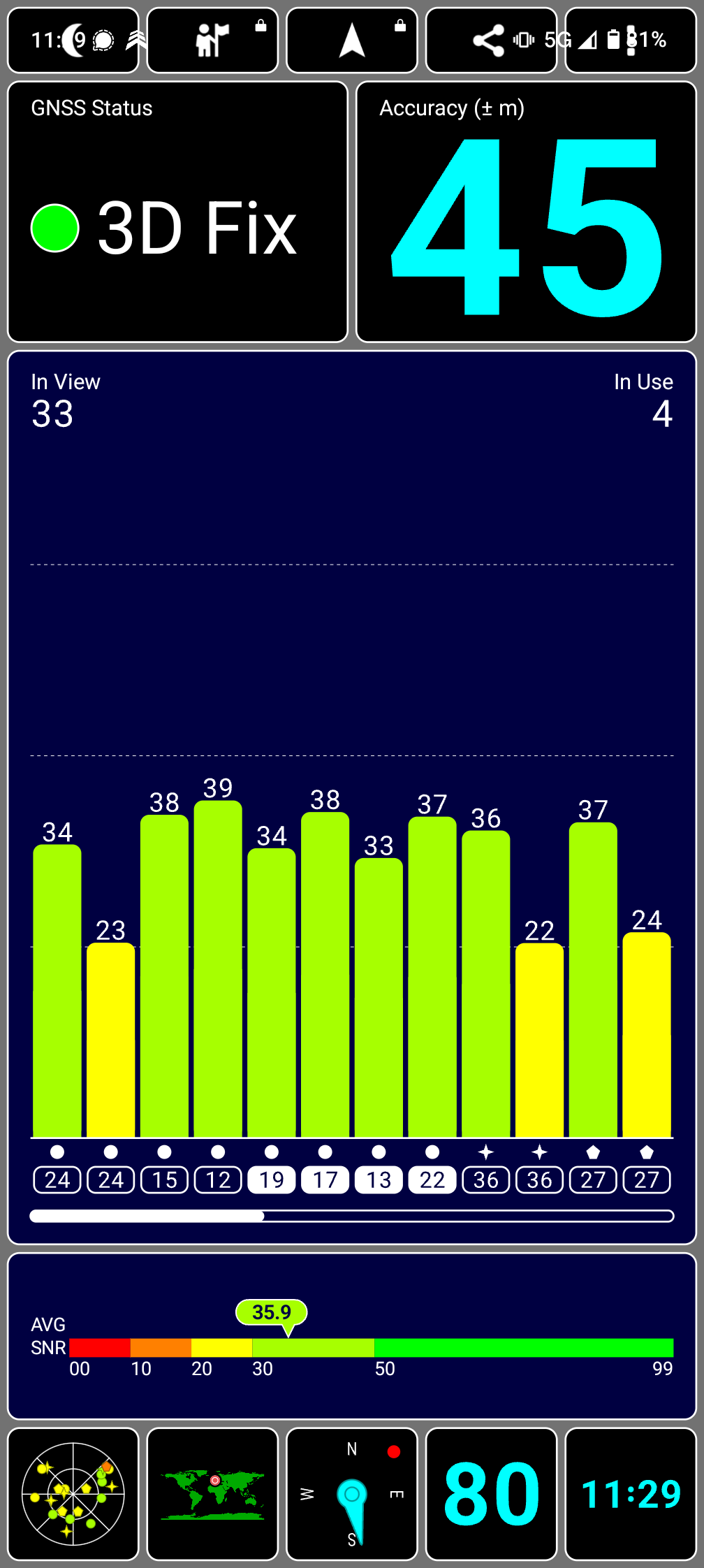

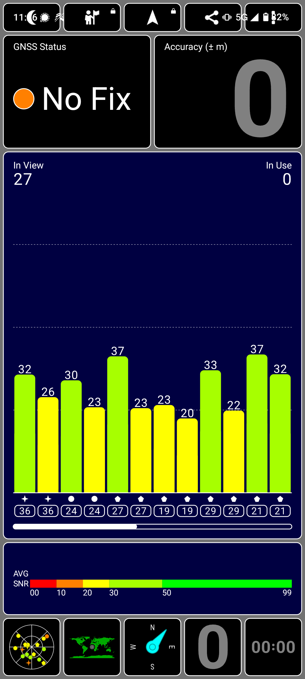

My reception is constantly very bad and it takes much longer to get a GPS lock if I even get a 3D fix… Sometimes I wait for minutes outside and still get no usable location.

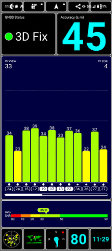

It got a bit better after another restart and carrier seems normal right now. GPS now takes about 30 seconds to get a 3D Fix which was definitely faster at some point

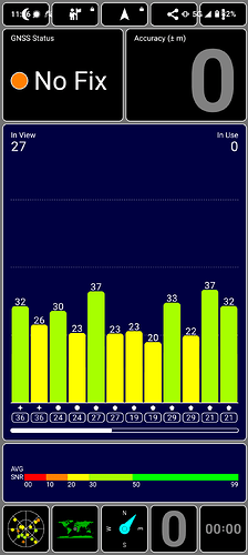

It just took about 3 minutes to finally get a fix even though I was standing in the open air??
It’s so much worse than on 7.0 and also less accurate

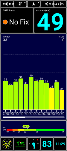

It keeps switching back and forth with the GPS test app.
only after waiting another few minutes it finally stabilized around 4-10m accuracy with a fix

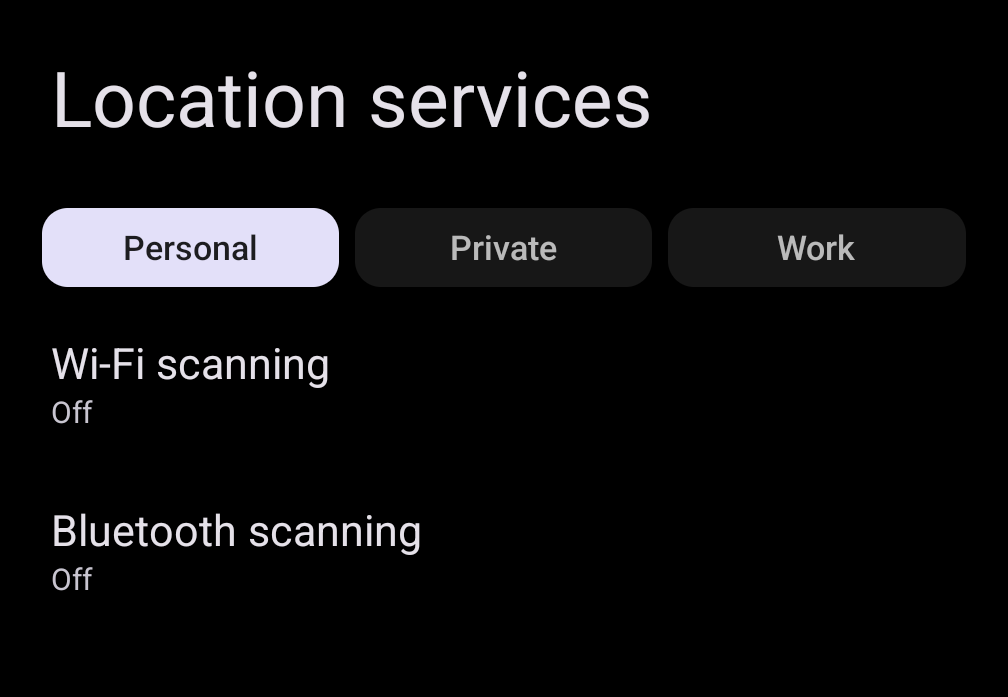

Not even turning on WiFi scanning helps. Is the iode Beta for Pixel 8 Pro still a thing? because there was a stable update after the last beta and no new beta. Is there a way to go back to stable?

Yes I have tried switching from Position to BeaconDB but I couldn’t notice a difference.
I meant these settings but I’d like to keep them off for privacy.
Thanks for the tip with the updater. Will try and hope that the next update will resolve this
So you do have “Use assisted GPS” under “System Settings > Location” enabled? (it is that toggle that will then use the microG location services in addition to only GPS data). But I do think you will have reduced fix speed if you have Wi-Fi scanning off.

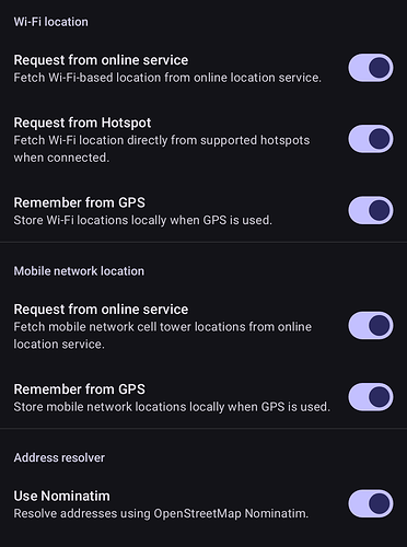

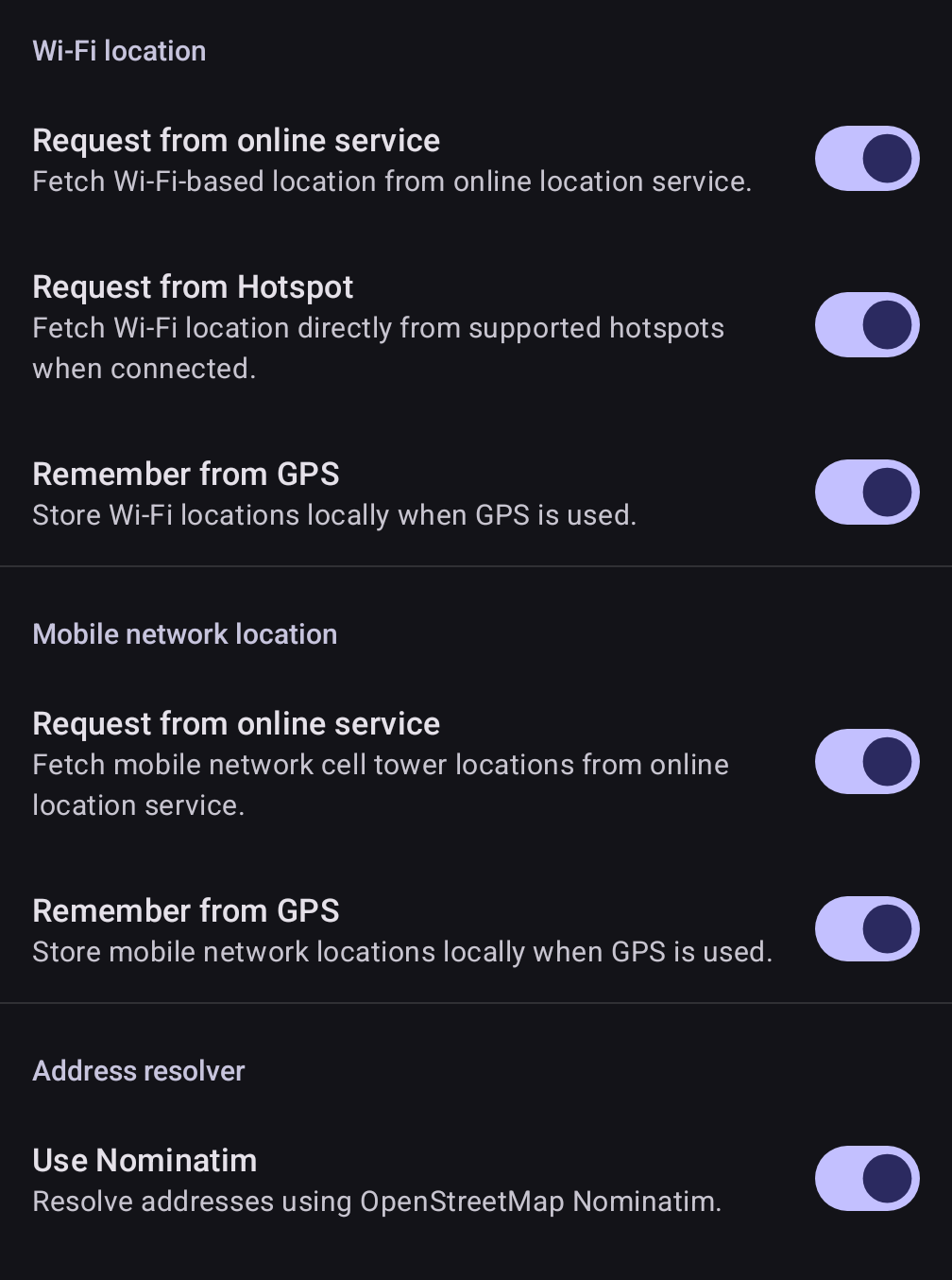

Under microG Location settings, do you have all those toggles on (Remember from GPS, Request from online service, Use Nominatim, etc.)?
I ask because your “3 minutes to fix” sounds like an expected “GPS only cold fix” so it seems to not be caching or using other helpers such as cell towers.
But I have had WiFi scanning off from the day I installed iodeOS and there was definitely a point when it always took under 30s in the past. “Use assisted GPS” is always on and I already tried toggling it off and on.
All toggles in microG are also on
