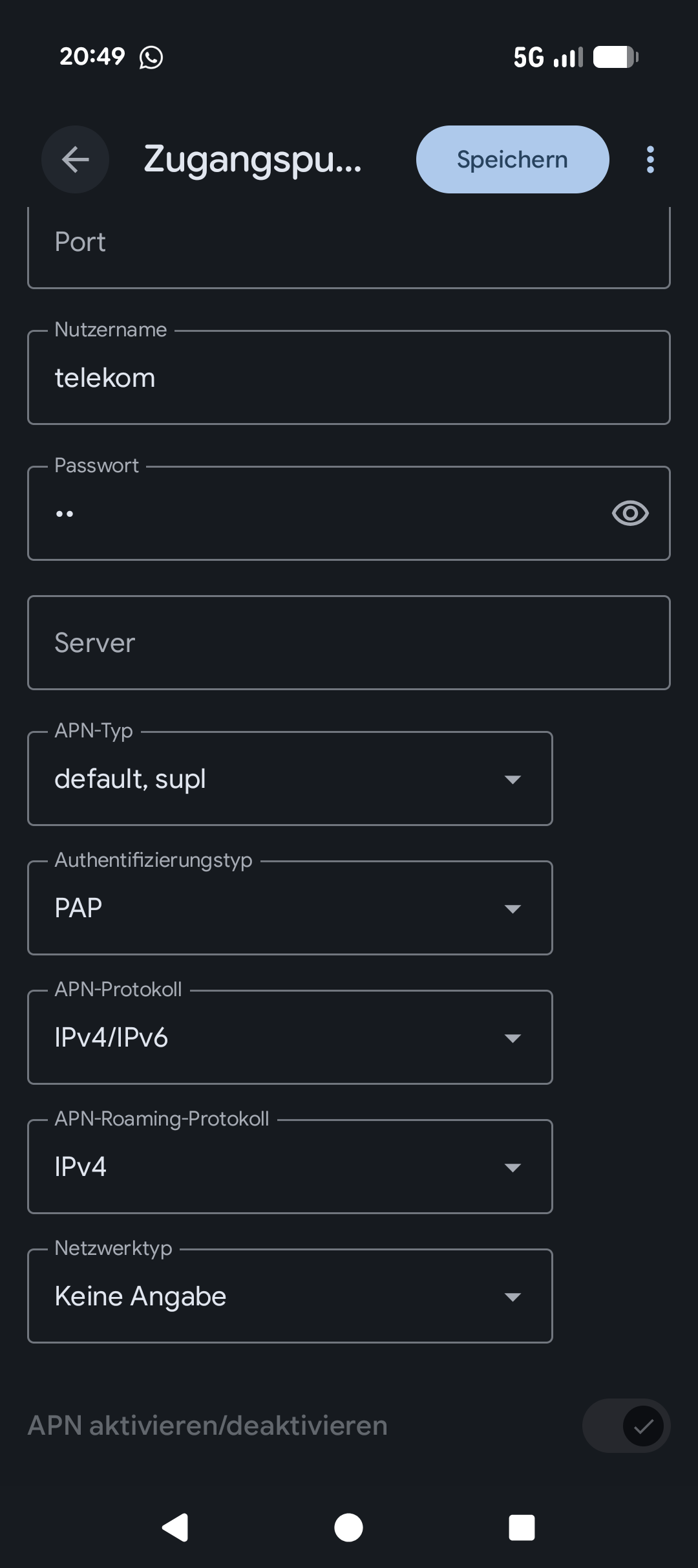

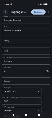

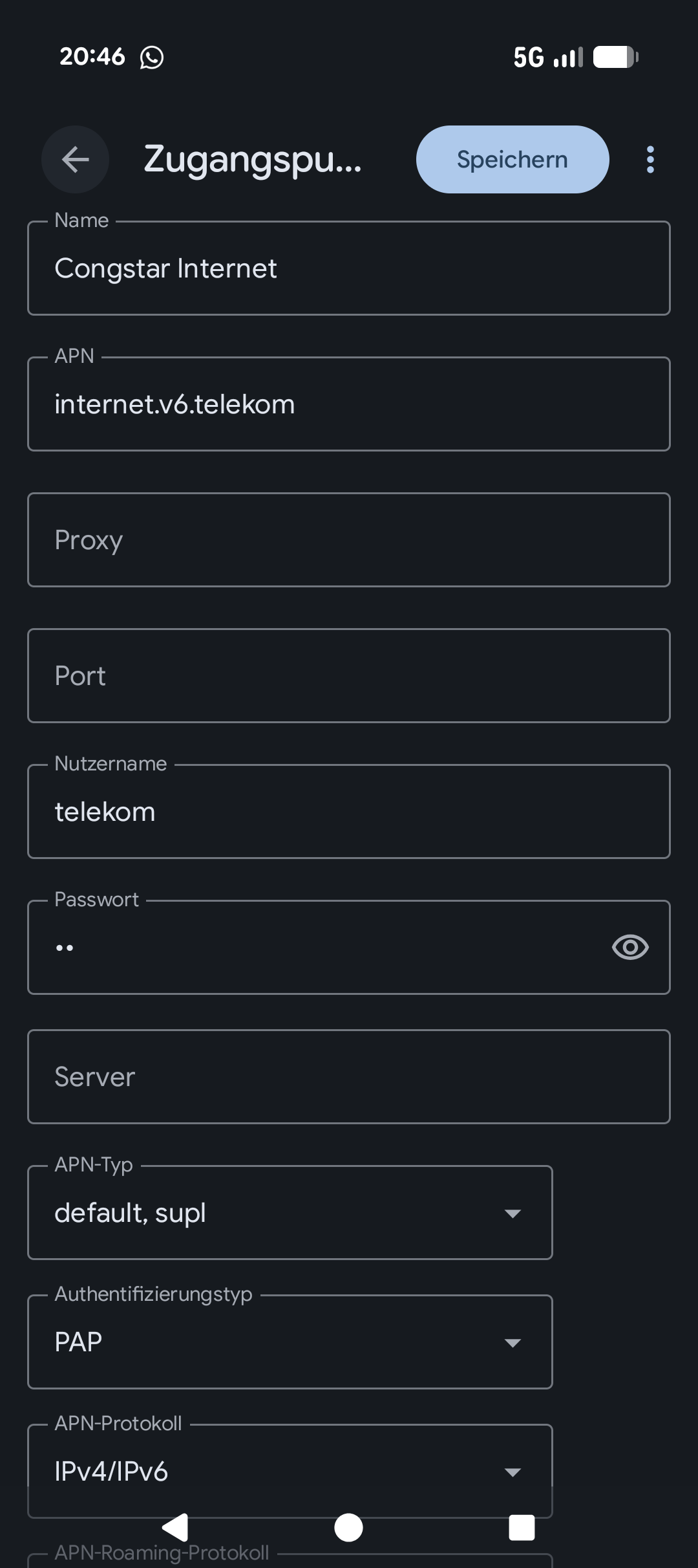

Ich habe die Daten angepasst, VoLTE wieder aktiviert und getestet. Das Verhalten hat sich leider nicht geändert. Ich bekomme wieder 2 verpasste Anrufe angezeigt und dann erfolgt der fallback und mein smartphone klingelt. Congstar hat mir die im screenshot angezeigten daten bestätigt. An den APN Einstellungen scheint es nicht zu liegen.
Please check *#*#INFO#*#* (INFO), Phone Information (v2), IMS tab, to see the status of IMS and VoLTE registration. I suspect it is still not registering.

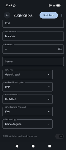

I have the same APN settings like in the two screenshots, and VoLTE is working fine on my FP6.
@torsten.berger please see this:
@vanMacG thanks for the feedback, can you clarify any other settings that may be different such as IPV4/6, authentication as PAP with 3 digit password, etc. Are all of those the same or just the APN Name field?
All fields from the screenshots are exactly the same.
Did you check with Congstar to make sure any configuration on their side is not possibly at fault? If you can look at *#*#4636#*#* too in order to confirm that it seems IMS is not registered it will at least verify that this is an IMS registration issue.
I don’t have any problems :slight_smile:
I just wanted to confirm the APN settings are fine.
PS: When I look at 4636 it say IMS: Registered
