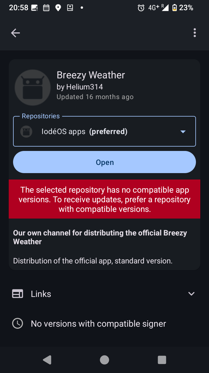

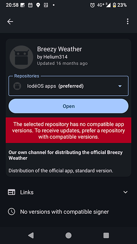

I also habe the Breezy Weather notification. It is a bit annoying but I also haven’t done anything. I suppose Breezy Weather detects that there is a new version on Github, but the version in IodeOS repository / ROM has not been updated yet. I hesitate to manually upgrade from github as I could imagine that it will result in some version conflict or so.
Edit: Fdroid also says something with incompatible all versions. IodeOS repository hasn’t been updated since 13 months, however Fdroid has 3 months ago and IzzyOnDroid even only 13 days ago. Is this maybe related to the issue?

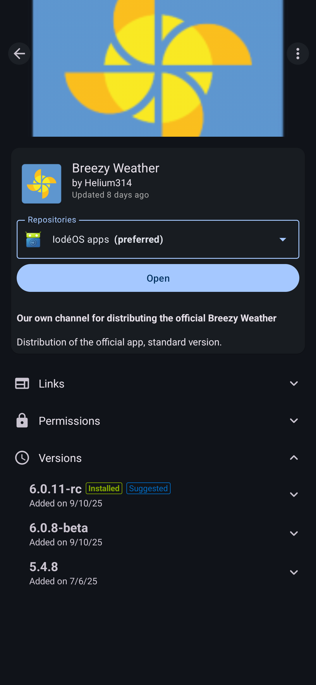

Confused, as this is what I have from F-Droid (note that the date is 9/10/25, with the prior version being only a few months ago).

For @Xyguma and @rom4nb it really seems to me from the message in your F-Droid that the version of Breezy you have installed is not compatible with the updates from the iodé repository. I am not certain why this would be. I suggest that you go to “System Settings > Apps > Preinstalled Apps” and remove Breezy there, then reboot, then re-add Breezy to “Prienstalled Apps” and once again reboot.
Thanks a lot, I uninstalled the app and reinstalled it and the notification is no longer there.
I should have tried that myself, sorry…
But the problem seems solved.
