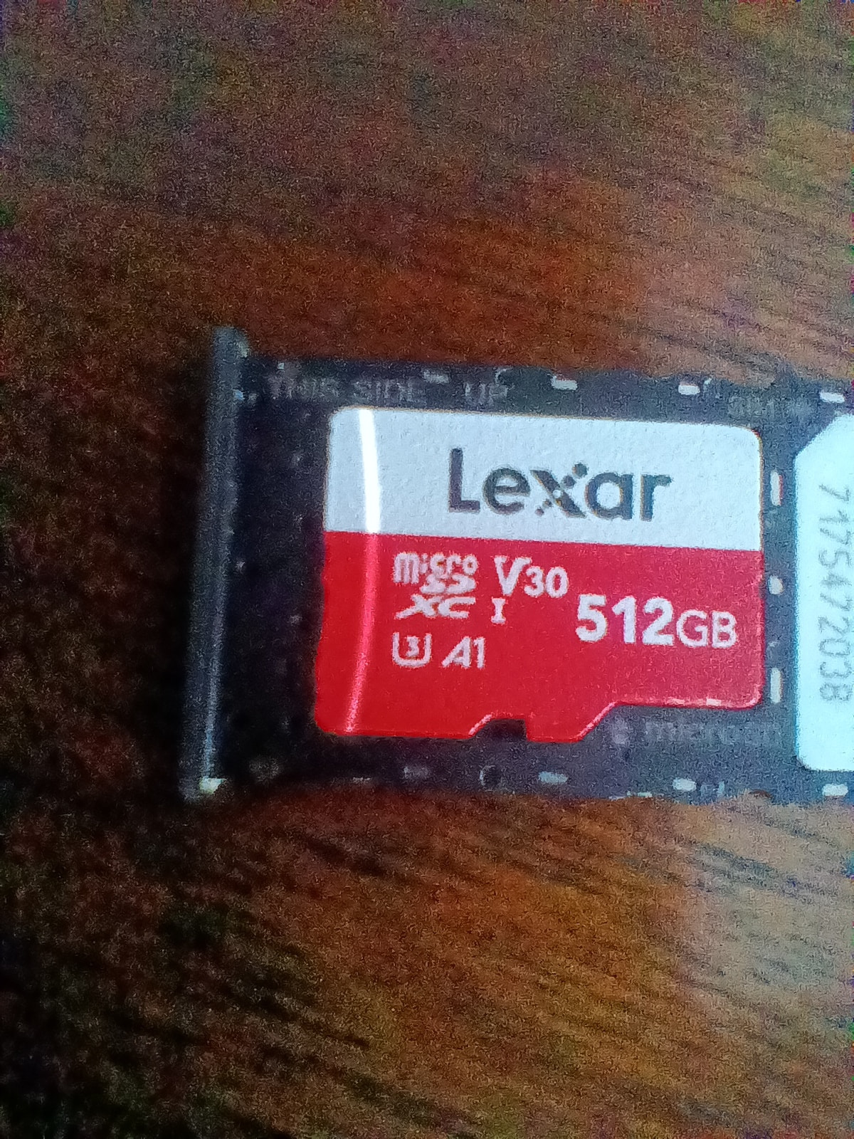

I’ve used this in two Brax3 with no issues.
Where you may run into issues with a card larger than 256GB is if you format the card as part of the onboard filesystem, instead of a separate filesystem. That is where I could see issues come into play.

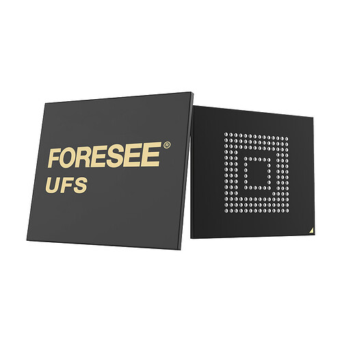

That is questionable…. Ever since the Brax3 was on Induegogo it has a listing that some, including myself, questioned. I posted the page here… but somewhere I found maybe the chip manaufacture site, that the chipset supoprted 512 for the SD Card itself.
https://www.indiegogo.com/en/projects/braxtechnologies/brax3-the-most-privacy-friendly-smartphone#/section/project-story
OK, so I think it was that the 6300 supports UFS 2.2, which in turn supports up to 512GB… that may be why I tried it.
And Lexar lists this
Anyway, it works with both exFAT and EXT3/4 formatted on a linux box. And i swap it between two Brax 3 and a Fairphone 4 with e/os A14. Never have issues.

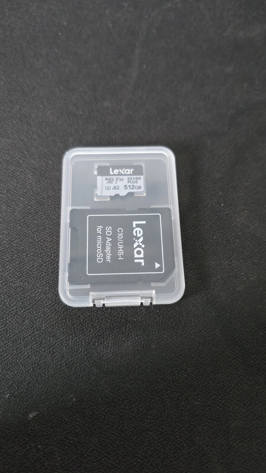

I’ve just ordered a Lexar Silver 512gb to try that one out.
So you recommend formatting the card as and external card, and not part of the Brax phone file system?
My issue is that I wanted to use the card to expand my phones ability to download music from the Spotify app for offline listening.
I can now confirm that the Lexar Silver Plus Micro SD Card 512 GB, formats and works flawlessly up to 205 MB/s Read Speed, 150mb read speed, in the BRAX

Thats a good rate. Better than my card on the write side for sure.
So I read an interesting post a while back where someone “extended the interal file system” with their SDCard. Then a short while later the card failed (maybe becasue they exceeded the UFS 2.2 spec with too large a card) and their device was corrupt. The interesting part of the post was that they could read data on anything under the 256GB limit on that external card. But everything outisde of that was bad. So in essence it corrupted heir file system. (that was the theory anyway)
And that is why I referred to the UFS 2 spec, and the confusion around what size card is safe.
If you wish to “extend” the system, then a 256G card would be the max safe size. If you just using as secondary storage, like exFat or something, then you could possibly go even higher than even 512G.
