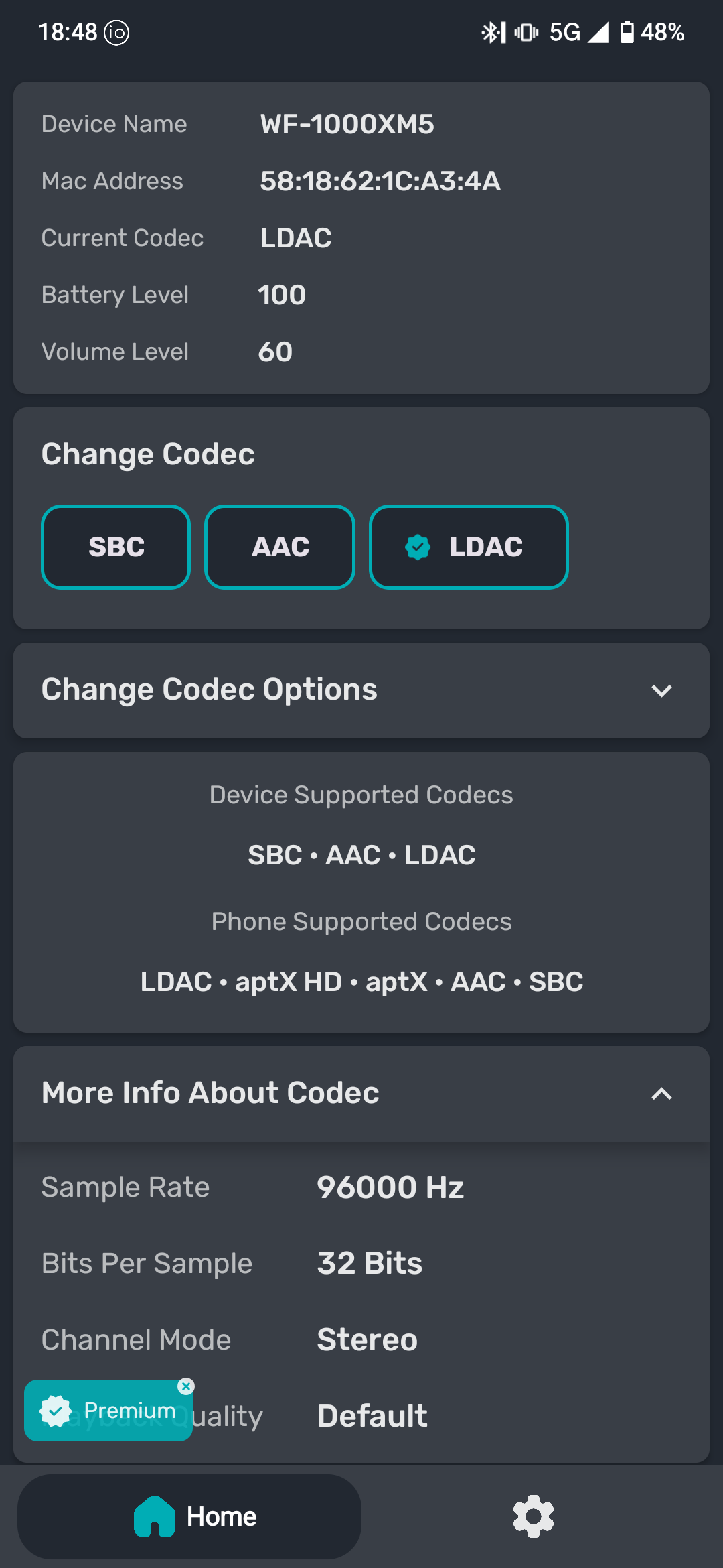

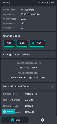

I got the recommendation to try different codecs for bluetooth using the “bluetooth codec changer”:
It did not help though to use any of the available..? I guess that the mic is used for aptX only, as I remember it working a while a go with a different headset?
