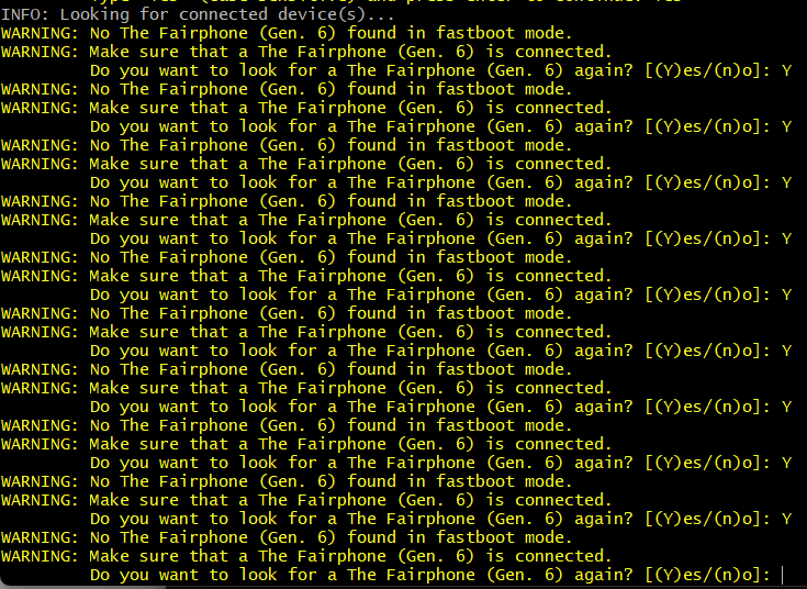

Back from de dead -> the next episode of my journey to install iodeOS on FP6
Hello several month ago i tried and failed to install iodeOS on the fairphone 6. I opened a thread back then which is linked down here :
I sought more answers on the Fairphone support forum, which is also linked below :
Then i dug a virtual hole and buried the fairphone for several month.
Today back from the dead, I did manage to install the FPOS from March → FP6.QREL.16.48.0.20260210142132_WS15-factory (Security patch from 05 February 2026)
So i could boot into the fairphone, great success.
I made sure bootloader was unlocked, in developper option, it’s greyed out but seems to be unlock ( i did not relocked it myself.
As i read other thread like mine on this forum :
I still have questions (sorry) :
  1. It seems i can install last image from iodeOS for the FP6 → iode-7.5-20260506-FP6-fastboot.zip
    BUT is i’m still scared of the “device corrupt stuff” from a wrong SPL, how can i make sure that i can lock the bootloader ?
  2. If we figure out it’s not possible at the moment because the SPL will not allow it, can i let it unlocked for the moment and then wait for 7.6 or 7.7 for the security patch to be greater and then relocking it confidently ? (losing my data in the process)
Thank’s for your help !
