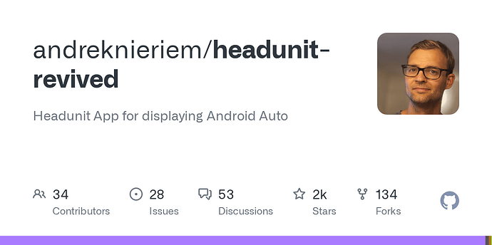

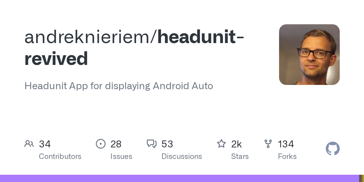

Side note: I am getting a Samsung Galaxy Tab S7 for user support as I now sell them through OpenMobile, and I am planning to test “Headunit Revived” on it to let it act as the Android Auto headunit for my cars as all are too old for AA.
