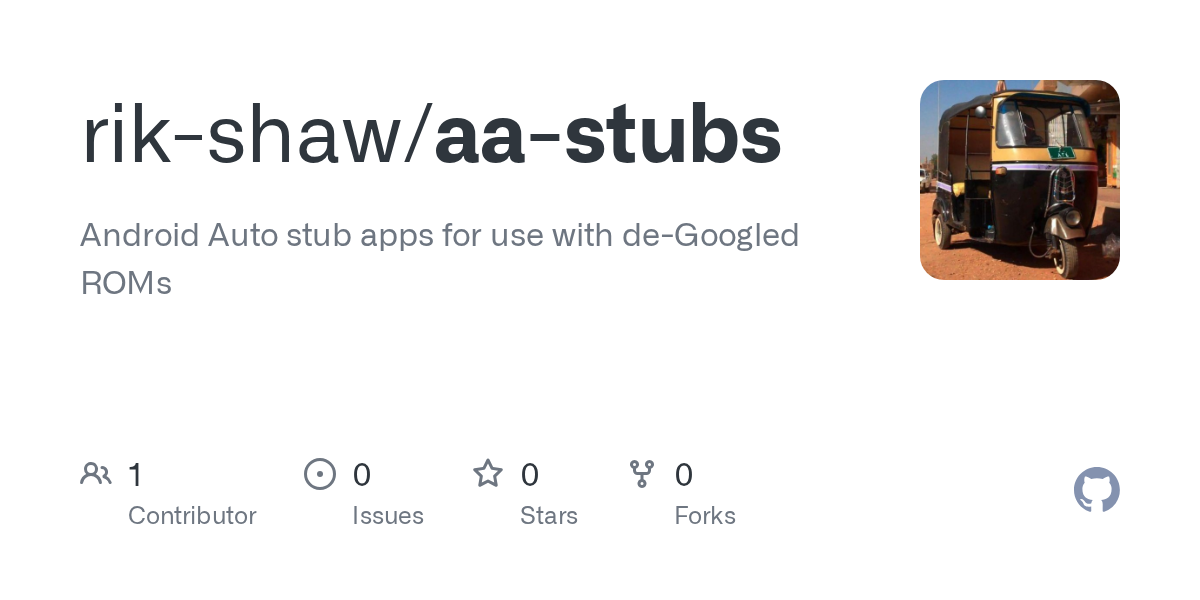

As @volker01 notes a few posts up, 2 of the stubs are coming from aa4mg (TTS, Maps), and 1 (“Google App”) from other places. I put all 3 togther, and posted them here:
I also added a very basic overview, noting that rooting (Magisk or other) is not needed for iodé because we already have Android Auto stub at the root level (for this very reason). But ROMs without that root level stub (LineageOS 4 microG, etc.) will likely need rooting for AA to work.
For @Guardian24 and wireless AA, it may be I didn’t have everything right, but wireless AA on my “stubs only” device gave the same “intermittent at best buggy results” as on my other device that had the full “google apps” installed. I want to test another car, I am currently blaming Toyota for the poor AA wireless experience (the car owner on an iPhone also has headaches with it forgetting the pairing, needing to restart the car sometimes, etc :slight_smile: ) Anyway, I think “more research needed” but if you have a spare phone to test, could you try with only the stub apps to see if it may work?

I credit where I found them in the READMD.md in my repo, but basically 1 or 2 out 3 from aa4mg project (couldn’t find the “Google App stub there”) and 1 or 2 out of 3 others from SolidEva (couldn’t find the “Maps stub” there). I could not find license info at either project (and I think they got them from elsewhere, maybe aa4mg wrote them, I guess I could unpack the .apks and see if there is any licensing inside them :slight_smile: ) Point is, not sure but would be happy to credit correctly :slight_smile:
