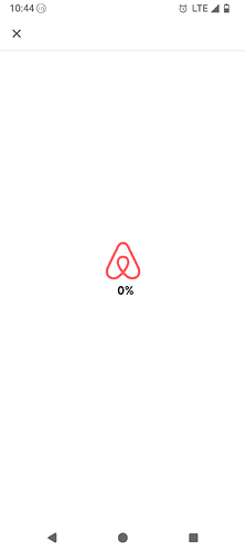

Airbnb app flashes 0% when trying to switch to “Hosting”. I uninstalled and reinstalled and the same problem existed. No way to get into Hosting portion of App.. In addition only temporarily at the beginning can I look at messages before it permanently flashes 0% "

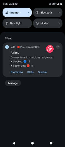

Please go into the iodé app, tap on “Apps under Standard Protection”, then find the AirBnB app and tap the “x” on the “Standard” button. This will remove blocking for it. Then restart the app and check. If this is then working, if you want to re-implement blocking you can re-enable “standard” protection, and back to the main screen of the iodé app you can follow the “Stream” tab, optionally only showing for the app itself, and add individual exceptions for addresses you want to unblock.

I removed io standard protection for airbnb app as you suggested and the airbnb app still gives the same message "0%. Any other suggestions?

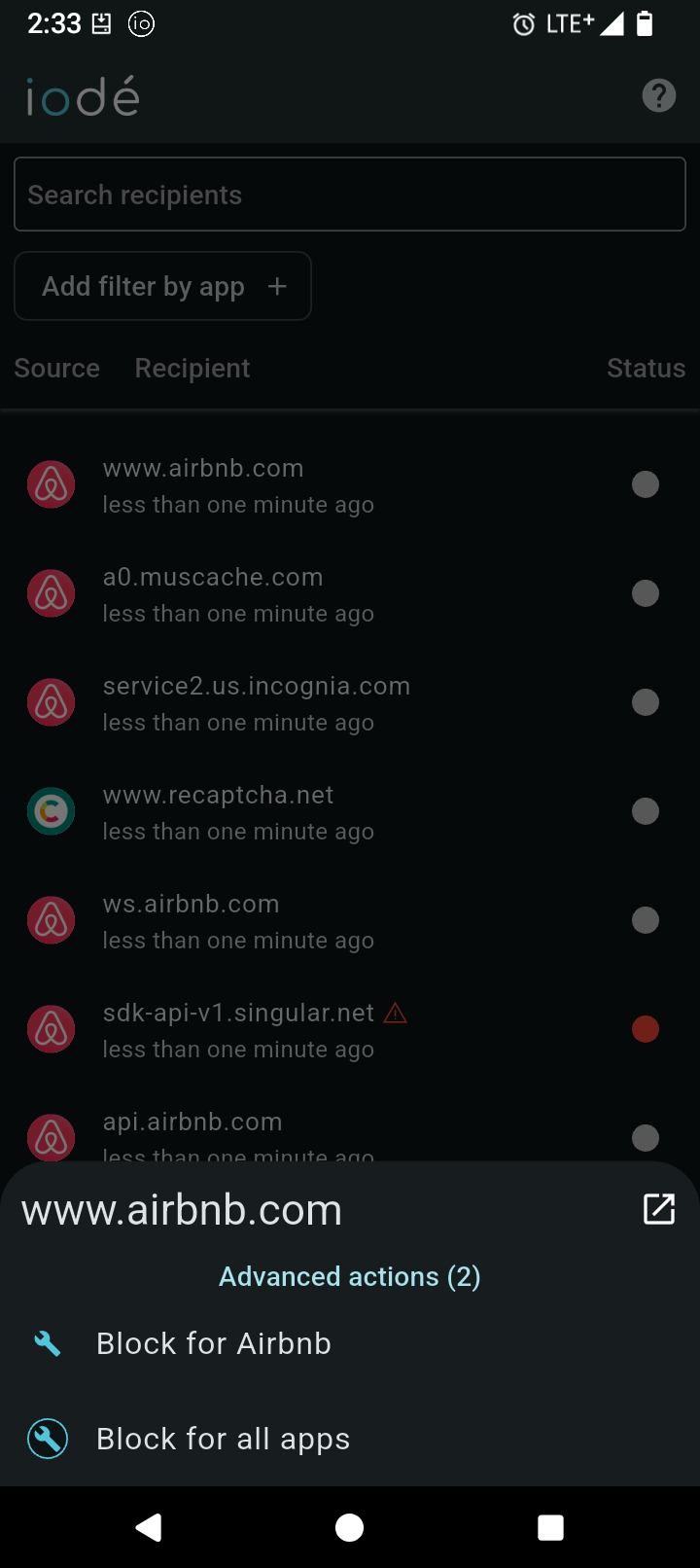

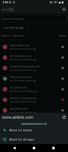

If you go to the iodé app and open the “Stream“ tab, then observe as you attempt to use the app. Possibly other things are getting blocked.
EDIT: I see that Plexus reports some problems with “host mode” which seems to match your findings. So it may be that it isn’t working without full Google Play Services. Can you access the functions from a web browser?
