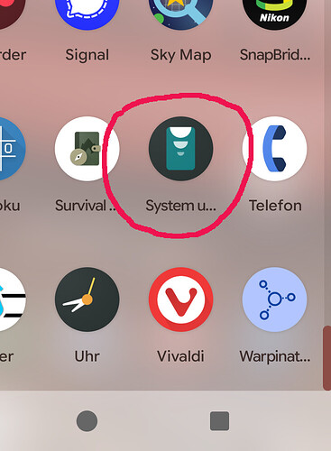

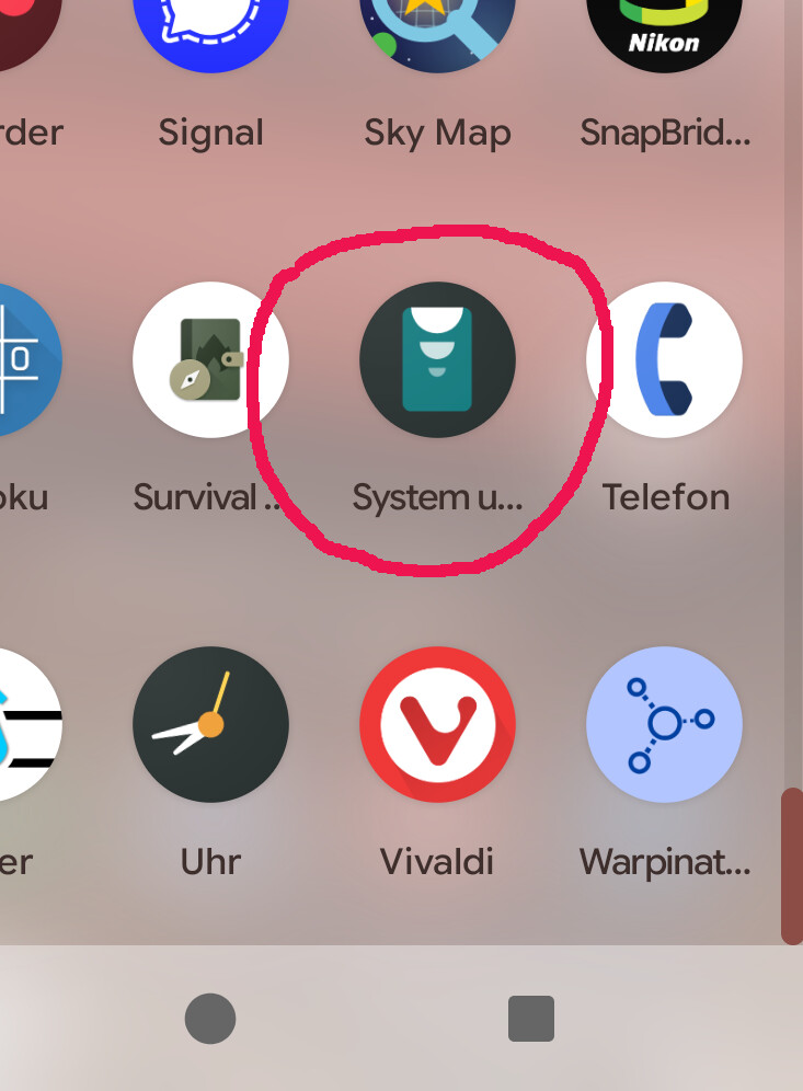

What do you mean by “updater app icon" ?
I don’t have any icon called updater App.
Thank you very much.
The app called “Updater” (on your homescreen under the Settings circle if on a default iodéOS install, or from your main App menu). Long press it’s icon :slight_smile:
You should have a System updater app. That’s the one.
Thank you. I had never used that icon before to get to the upload section of the system.
All good now. :+1:
