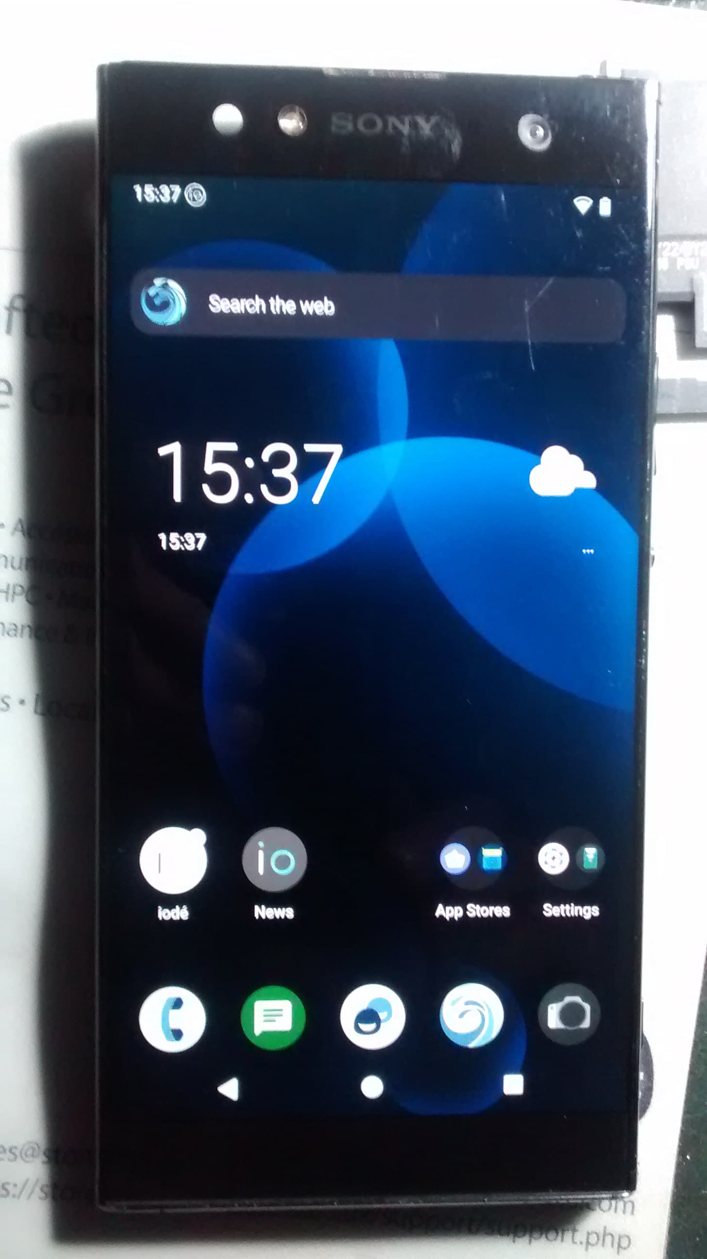

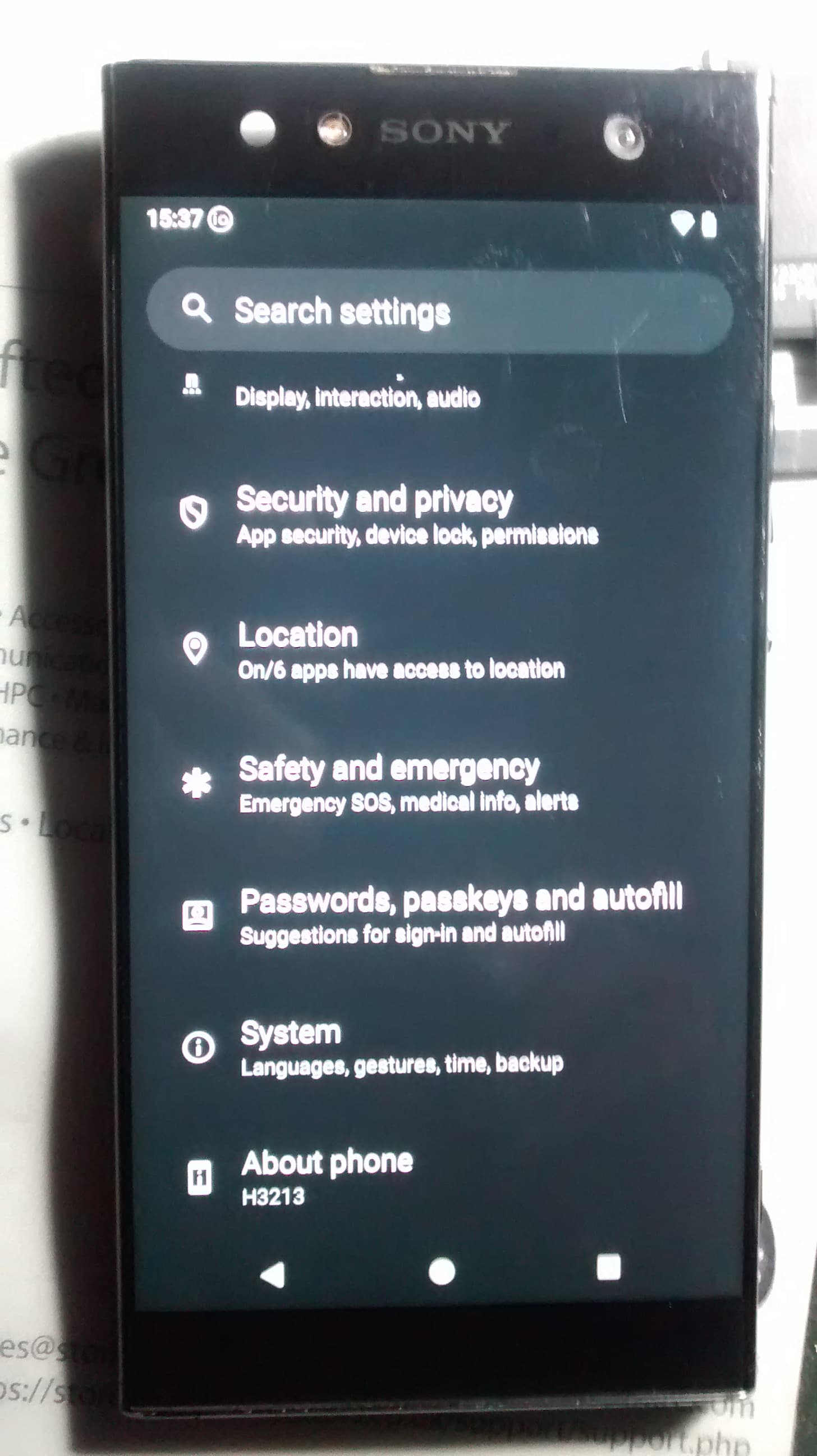

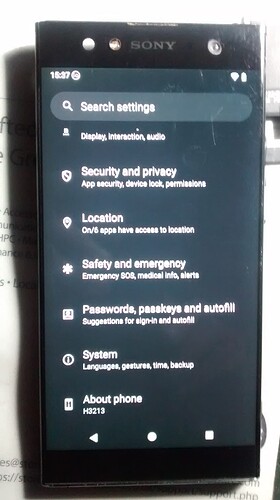

Had to wait an extra couple of days for the charging port PCB for the XA2 Ultra to arrive @petefoth but got on with it this afternoon and can report another preliminary success.
Need to spend some time with it so as I can test it more thoroughly but the Kirin version I installed on the XA3 has continued to work fine throughout the trial. I’m tempted to leave the XA3 running the previous version on the basis of… if it ain’t broke, don’t fix it. What do you think?
