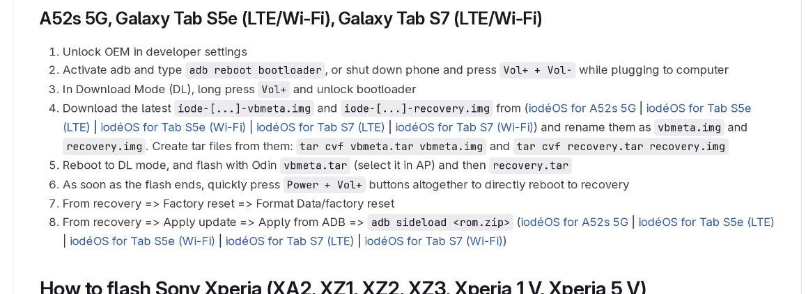

According to the Iodé list of supported devices, the Installer does not work for Samsung Tab S7… You will need to follow the “alternative instructions”…
My Bad!
I thinking that the Installer support all iodéOS Devices and not only selected ones.
