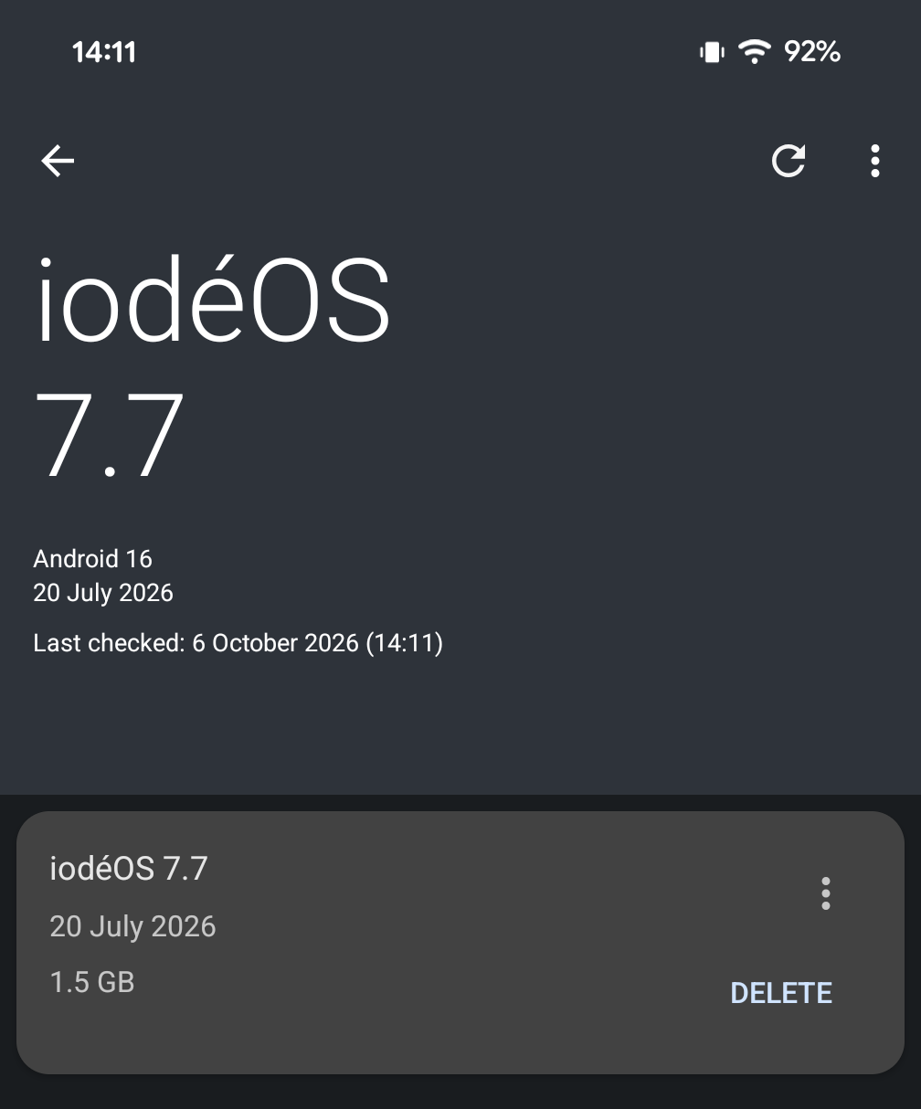

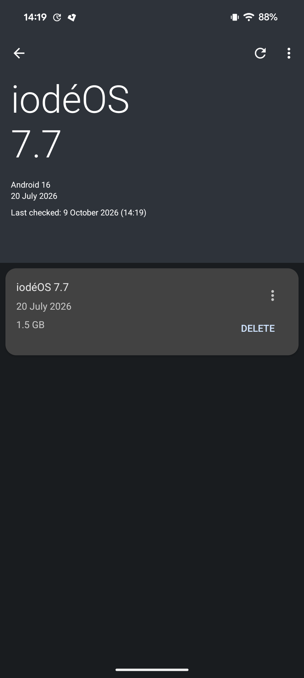

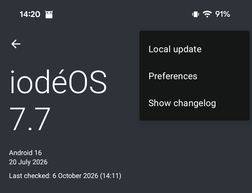

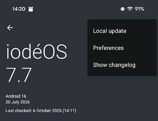

Hi @rik just to confirm I had uninstalled that special updater at the time - as per the instructions, on both my devices. I have rechecked and it’s definitely not there. Also there is no uninstall updates option in the 3 dots menu (so no option called Uninstall Updates - see second screen shot). Here’s a screen shot of what Updater looks like on the P8P, and the expanded menu:
The Local Update option just opens file browser to find a downloaded package for install.
Note my Brax3 is showing the new updater and I have done everything exactly the same on both handsets… So a bit stumped.

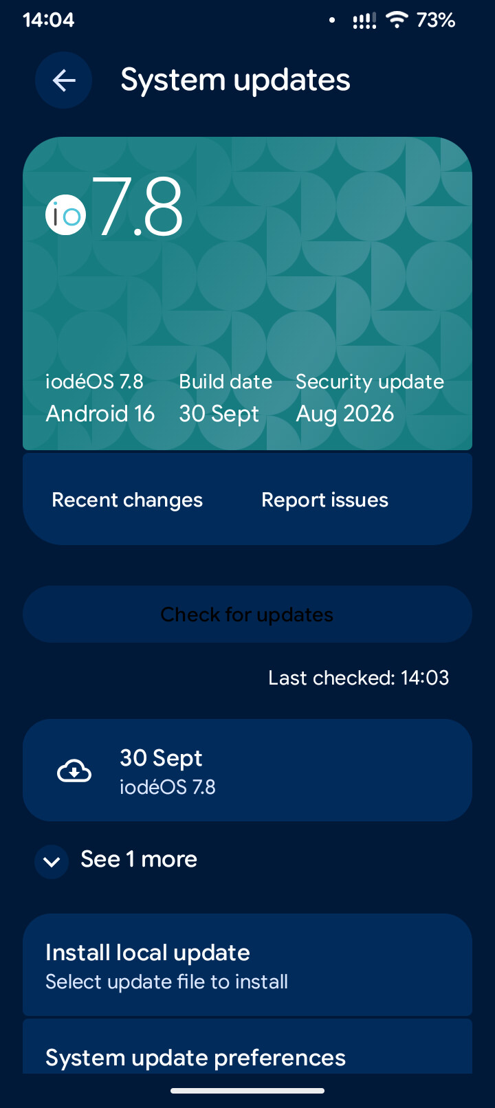

I have installed 7.8 (on BraX3), only just shown up in the last week in the updater - so will see if that changes anything… Still waiting for it to show on the P8P (always seems to take 3+ weeks to show up) - will see if that updates the P8P updater to new GUI…

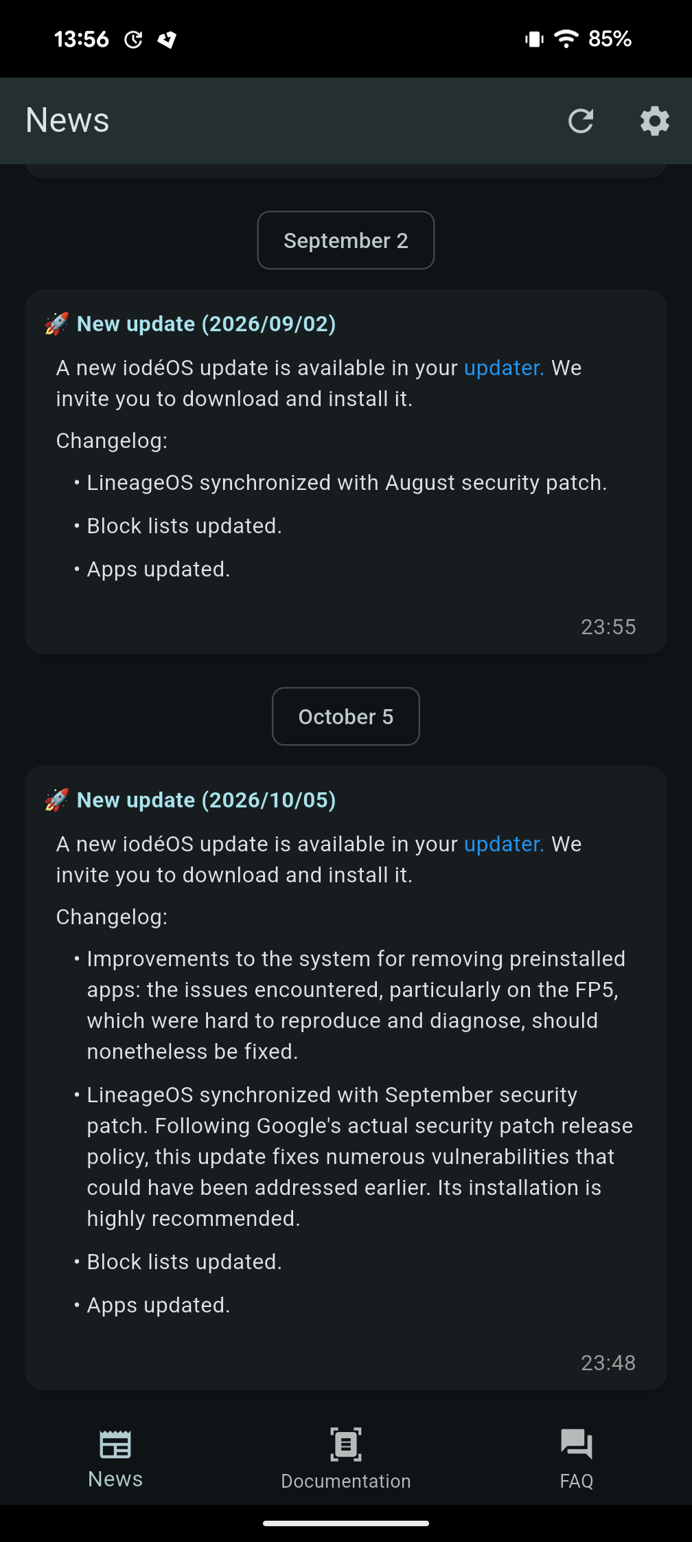

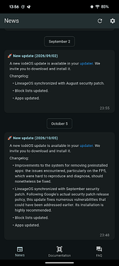

Further to above: @rik @vince31fr I just realised the News app on my P8P is showing 2 updates since 7.7 on 20 July - but neither are showing in updater (and updater has old GUI as above). Do I need to nuke the phone and reinstall iodéOS from scratch? Or can I download the updates manually and do a local update?
Versus:

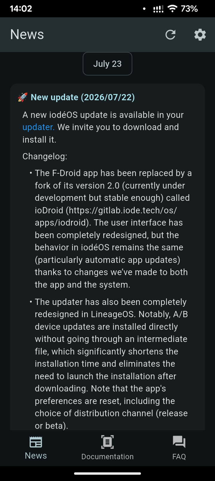

And conversely I’ve just realised my Brax3 has updated to 7.8 (today) but the news app isn’t showing anything since 7.7 on the 20 July??! And the September update never showed - just the new October one in the last few days…).

So P8P has 2 news notifications of updates since 7.7 (in Sept & Oct) but is still stuck on 7.7 in updater (with the old GUI); and Brax3 is up to latest version of 7.8 (and has had new updater GUI since 7.7 in July), but has no news notifications since the 7.7 update on 22 July…
(…and neither have the old manual update(r) from 6.9 to 7.x still installed.)
