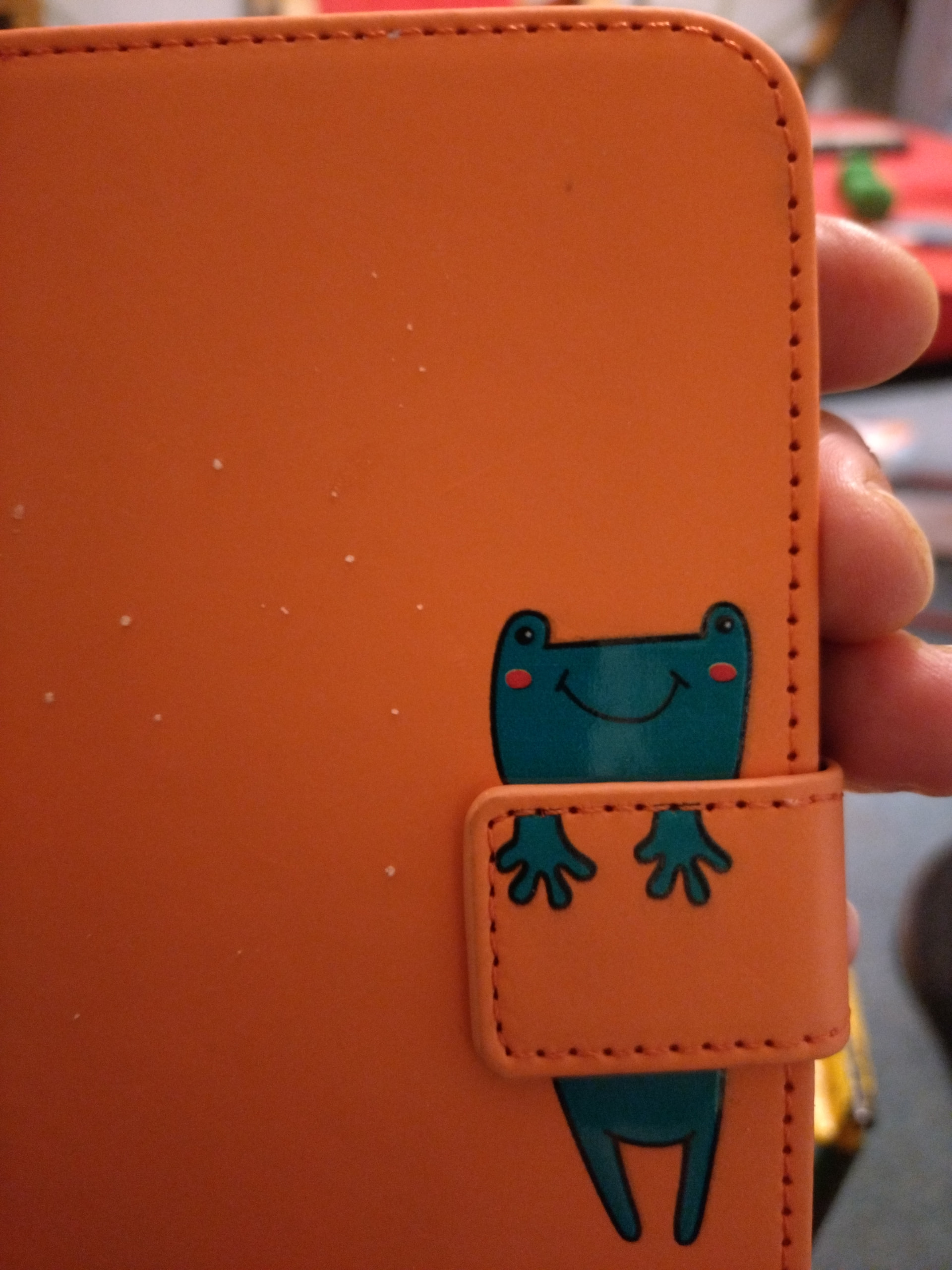

That’s what I get, if I tap to focus, it is shortly visible but ends up like this :slightly_frowning_face:
You could try installing the Aperture app from the ioDroid repository as a temporary fix. I’ve installed it on a couple of Sony’s and found it to be very good, but bear in mind I’m also a point and shoot guy same as Pete Foth.
the above picture was taken with the Aperture app, also tried OpenCamera and Sony Photography Pro, all worked fne with 7.7
