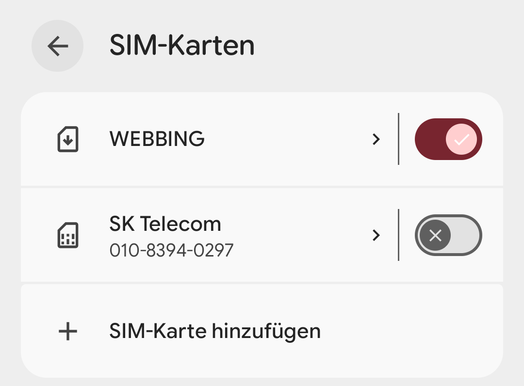

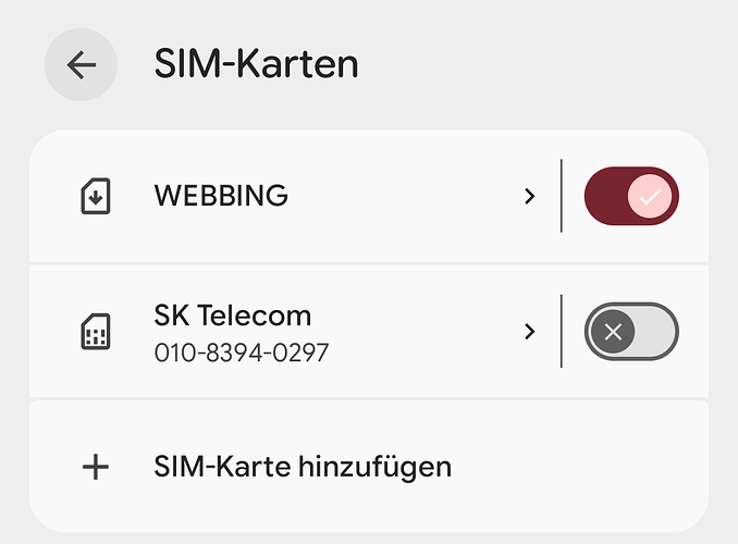

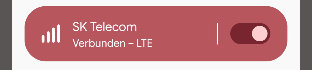

I have activated the Saily eSIM; the physical SIM at the bottom is deactivated.

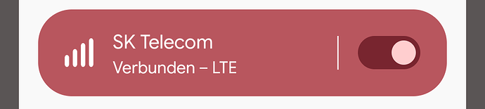

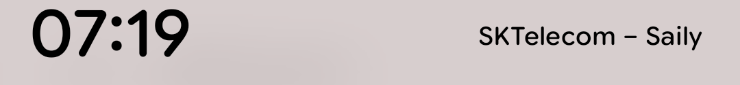

You can also see the Saily Net at the top
However, a data connection cannot be established.

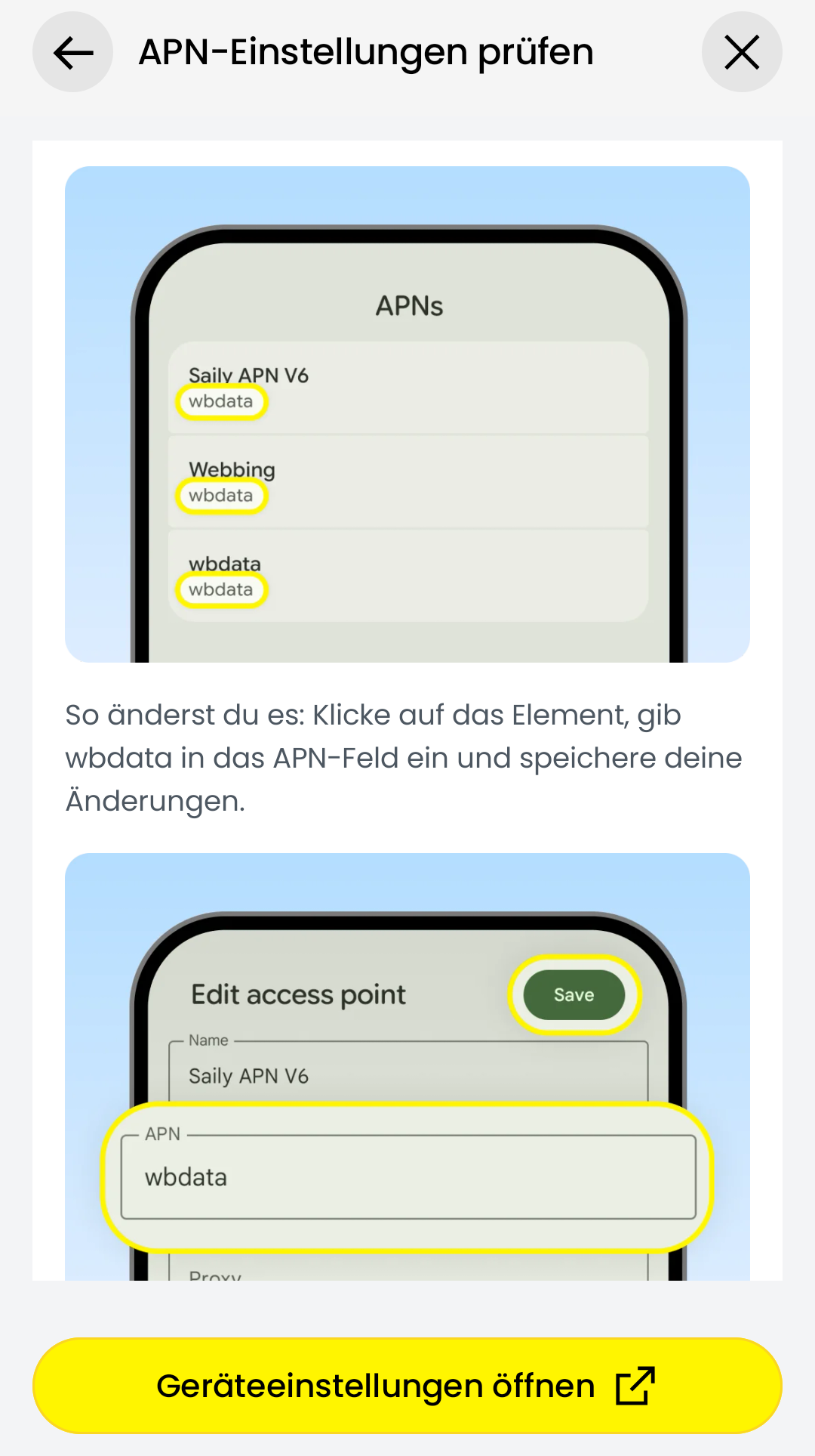

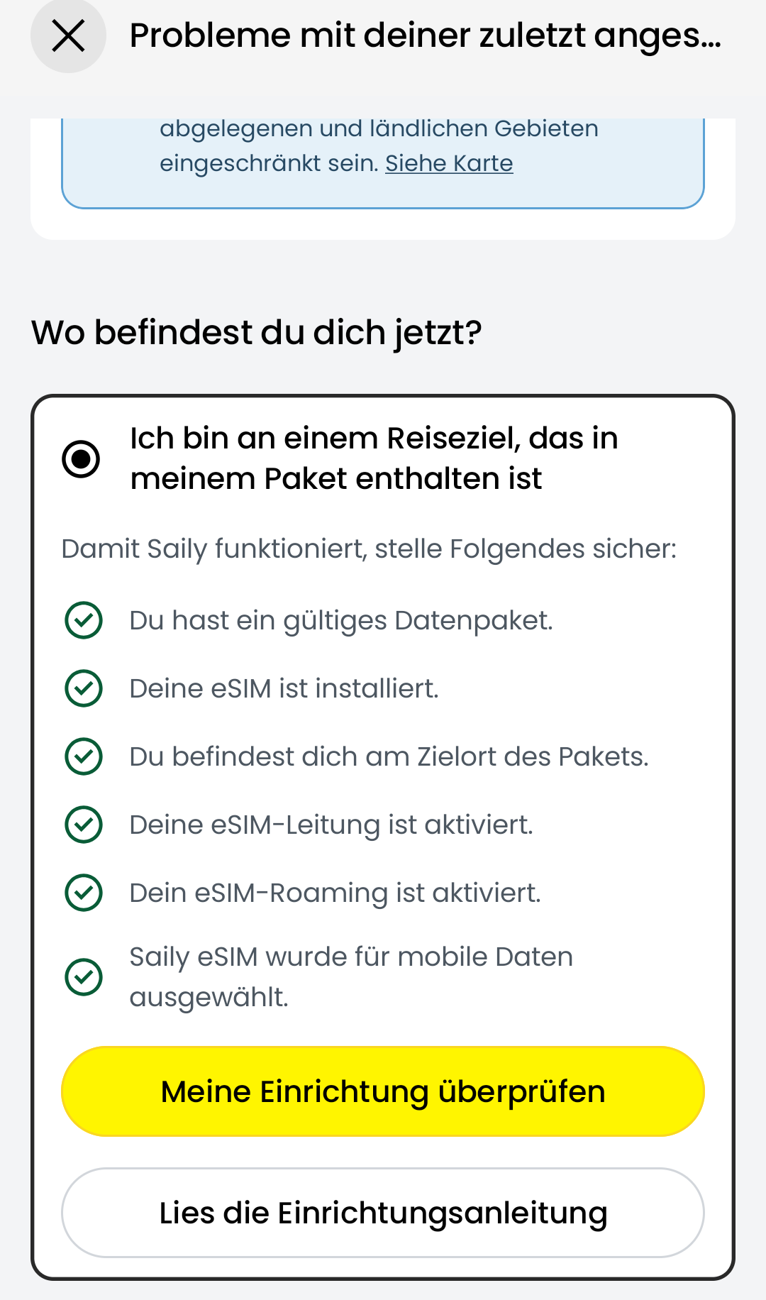

The Saily app recognises this too.

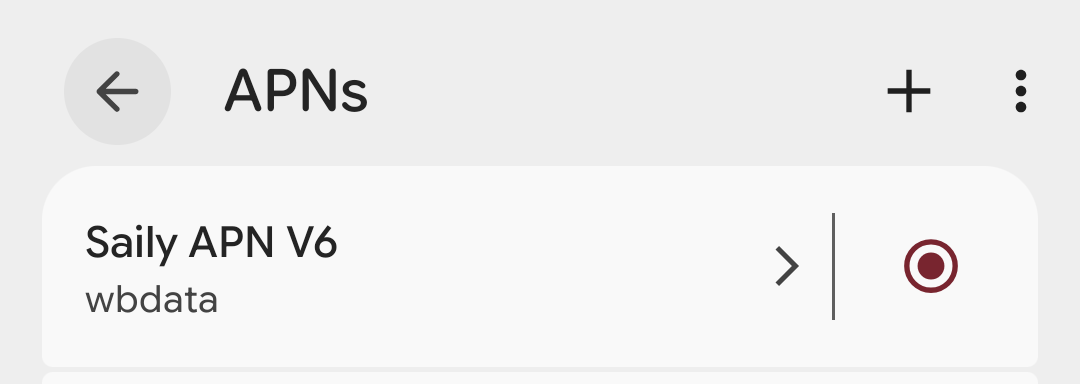

And it says I need to configure the APN.

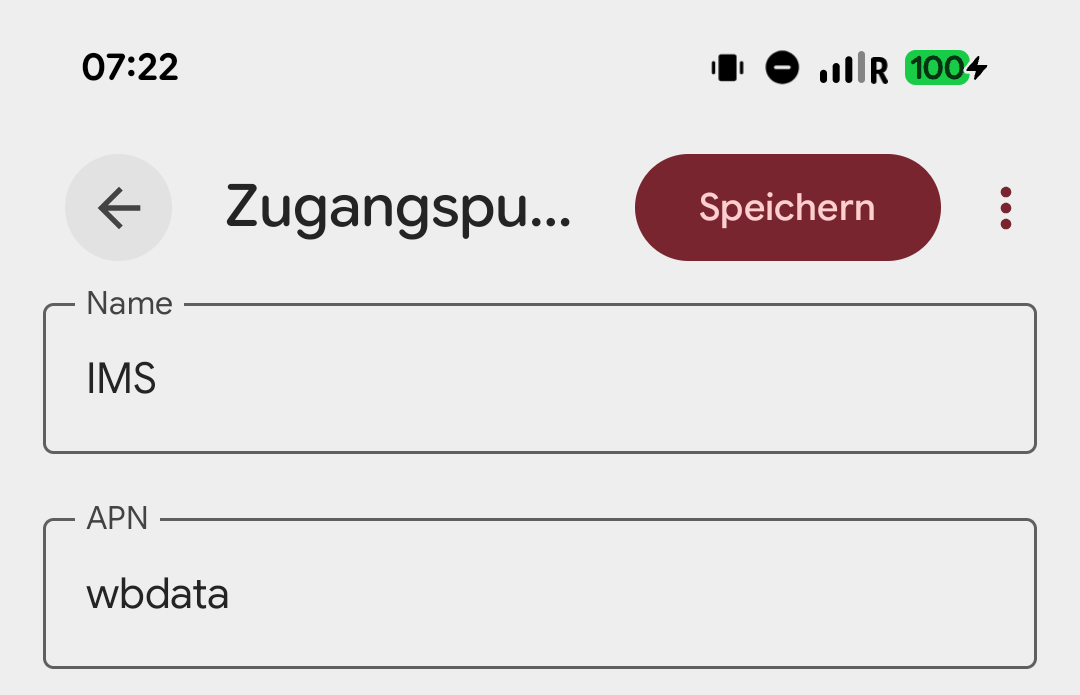

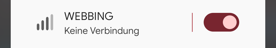

Whether editing existing ones…
… Or create a new one. Nothing works.
