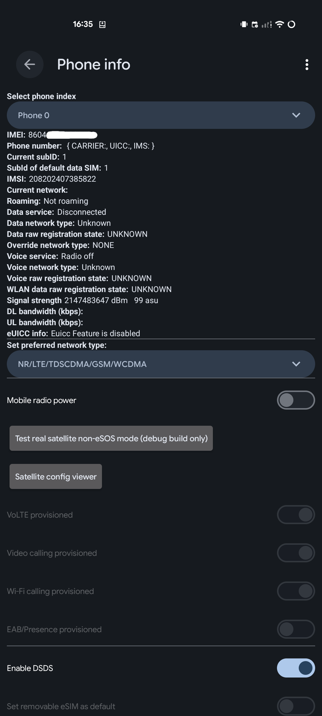

I very recently purchased a OnePlus Pro 9 (model LE2125) with Iodé 7 installed from your platform, and I’m having a problem with mobile connectivity: it simply isn’t working on this device.
I tried the SIM card in another phone and had no issues.
I’ve tried a number of methods to resolve the problem, but nothing seems to be working.
I do have an IMEI, and the phone seems to recognise my SIM card, but the mobile connection isn’t working.
I’ve tried:
  • enabling the mobile data connection
  • restarting the device
  • resetting the default APN
  • switching aeroplane mode on and off
And it still isn’t working.

Here come some Claude conversation i had, with some adb outputs :

*#*#4636#*#* says: Mobile radio power = ON
The actual ServiceState says: mVoiceRegState=3(POWER_OFF) then OUT_OF_SERVICE, with cellIdentity=null, channel=-1, technology=Unknown
In other words: the Android framework believes it turned the radio on, the Qualcomm processes are running, but the modem never returns any cell info at all — not on 4G, 3G, or 2G, across 13 hours of logs.

my other SIM doesn’t work in the OnePlus either, but the Bouygues SIM works in the Honor
There you go — that’s the decisive test I was waiting for, and the result is very clear.
:red_circle: Key result: NO SIM card works on the OnePlus at all, while the Bouygues card works perfectly in the Honor

Model LE2125 Hardware version EU
That confirms it: LE2125, EU hardware — this is exactly the correct European variant, fully supports French carrier bands. So we can now definitively rule out any model/region mismatch as the cause.
