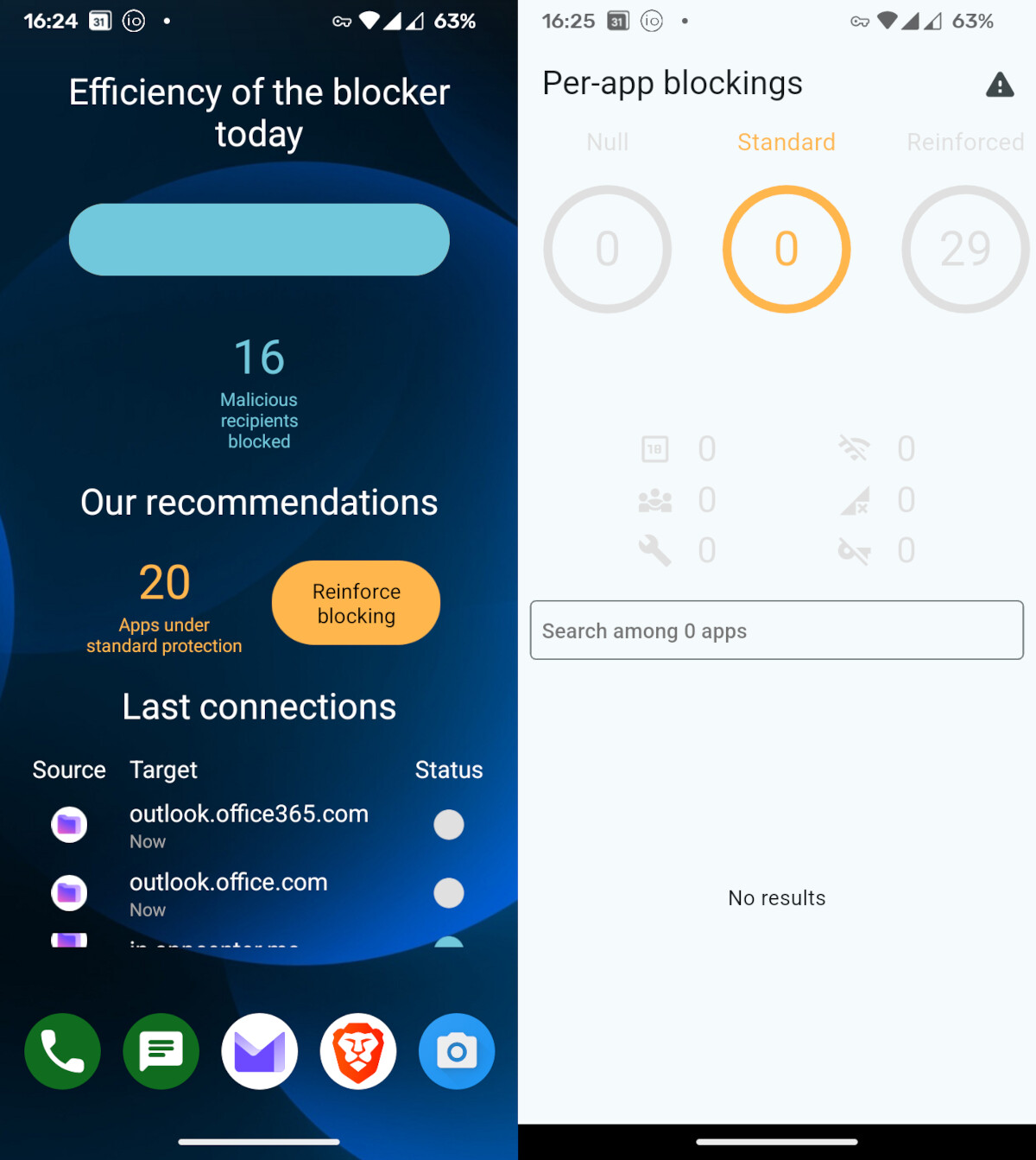

One of the homescreens on my phone has the iodé widget running, which shows me the last connections by apps, but also shows me a bar at the top between “Malicious recipients blocked” (in blue) and “Malicious recipients not blocked” (in orange). The title at the top clearly tells me “Efficiency of the blocker today”. (my emphasis).
Right now, for example, it tells me that 18 recipients were blocked, and 7 were not.
If I open the app version and ensure the selector is set on “today” then it tells me that “18 malicious recipients blocked”; 18, of course, matches the exact number the widget told me.
But… there is absolutely no mention in the app version of the 7 that were not blocked, the ones in orange.

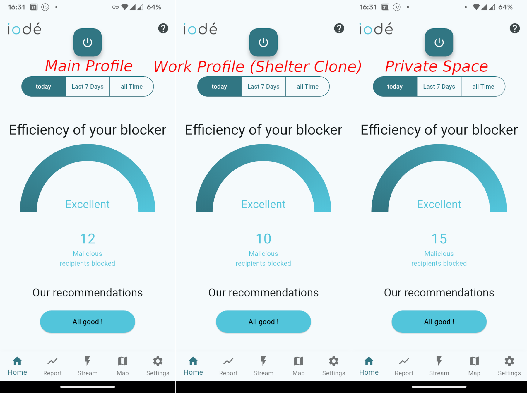

For the record I have been having the exact same issues. I open iodé app from the main profile, the work profile (within Shelter) and the version in the private space and all show everything blue, and only differ with the MRB Number in the centre of the screen. I see everything as described above, including the desktop widget, as showing numerous unblocked ones in orange (e.g. 20+ for me) and PLUS however tapping the widget fails to load the iodé app too, it opens but comes up blank of data and says something about the blocking may be causing the issue present. But iodé opens fine from the app shortcuts in all 3 profiles listed…?

Thanks @rik - FWIW I’m continuing to see inconsistencies and such. Effectively I have 4 instances of iodé app, original in main profile, one I cloned into Shelter for work profile (after a while as all WP apps weren’t showing in main iodé app), the one the system cloned into Private Space, and the homepage applet on the main profile. All report different things, show a different selection of apps, and between them I believe don’t show a couple of apps I use that connect to the internet. The applet is always really bad and seems highly inaccurate or even is unusable with the message about blocking breaking things, despite having all blocking turned off on iodé app itself.

The discrepancy between the statistics it presents and the ones in the blocker also have an explanation, and that’s another point we have to improve. The blocker itself (not its GUI), is a low-level system process that has no knowledge of what is a system app and what is a user app. It blocks connections and collects statistics for all system UIDs, by default with the standard blocking list. The GUI has that knowledge, and presents statistics only for user apps and some system apps. Furthermore, actually, we can have control in the GUI (for changing blocking settings for example) only on user apps. However, computations in the blocker UI are costly, and in order to optimize the widget, it only communicates with the system blocker. Statistics are collected very fast and the widget does not consume a lot of resources. The drawback being that it presents statistics for all apps, including all system apps (event those not displayed in the UI), whose blocking list is the standard one: so there may be some ‘orange’ statistics…

Here’s typically what I get on my desktop applet/widget and when i click into it (i.e. on the reinforce blocking orange button). Note (1) at time of this screenshot I had all instances of iodé app ‘reinforced’, along with every other app showing in every instance of iodé, (2) Private Space is unlocked IIRC (that is where I have Microsoft Outlook & Teams reside - not Work Profile) so is why those outlook links are showing active at the bottom, and (3) the warning icon is present at top right - which has the message about reinforced or normal blocking may be preventing this app and other apps working correctly.
Changing iodé app to Standard or Zero blocking seems to have no effect at all on what happens when you click on the applet EXCEPT it will show 1-2 apps as not reinforced (i.e. these will be itself if I have changed it back to standard). But I have just retried now and it did show some difference from previous, perhaps due to 6.8 update change, so I will do new screenshots today to re-illustrate this and possible different scenarios).
Meanwhile if you open the actual app (in my case 3 separate instances) this is what you see:
As you can see this immediately shows no apps need reinforcing anywhere, yet the applet claims 20 in previous screen shot?
There is a 7 minute gap between the top image and bottom one but nothing changed - I didn’t change any settings nor go into iodé app anywhere. The screen shots of the 3 app instances in the second image were all taken in succession (left to right) over period of 33 seconds.
There different MRB numbers are largely irrelevant (as in Work Profile I had most apps frozen by Shelter except system ones) and in Private Space the apps were obviously unfrozen when I opened it to access iodé (see Microsoft processes comment above). But I would have expected the cloned Shelter app in Work Profile to have had a higher number than the main profile if it should have aggregated both?
