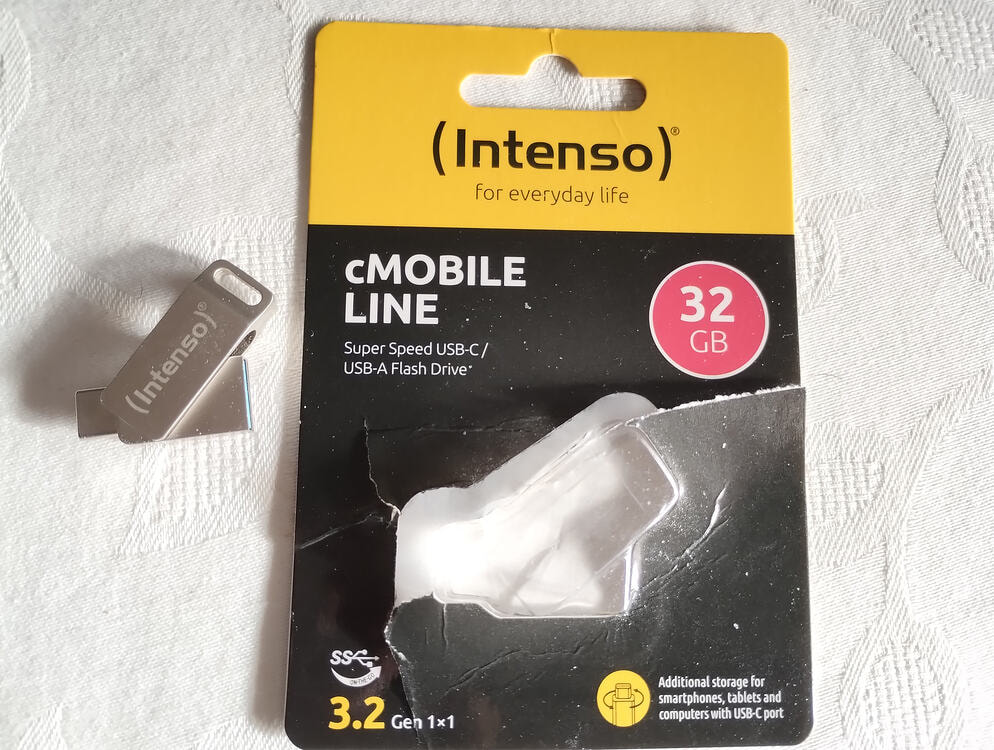

On which data carrier does Seedvault store te backup?
You can define that in the settings.
In my case, it is this data carrier:
